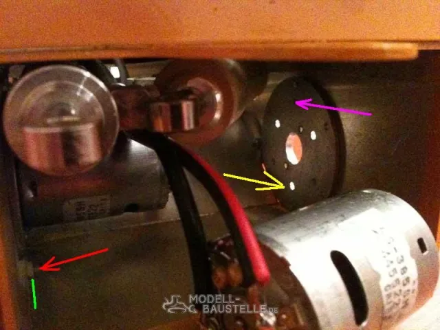

  • Hi all,
    I've had some time this evening to get back on track...hmm I mean get back to build the dumper :thumbup:
    I ran into a problem when trying to figure out how to place the 2 front motors :
    <a href="http://www.casimages.com/img.php?i=1009…48076801269.jpg" title="upload image" >Cliquez ici pour voir mon image</a>
    I couldnt really understand the following sentence :

    remove the gearbox from the motor by loosening 3 Phillipsbolts
    The 2nd bolt from behind at the lower floorboard has to be rotated CCW until it is flush with the nut.
    now the motors can be installed.
    Please note that one of the gearbox fastening threads must point to 12 o'clock position."
    If someone could explain I would be grateful, because so far I couldnt place the 2 motors inside the front part :
    I need help :bitte:
    have a nice evening,
    Dimitri.

  • Hi Dimitri,
    hm, as far as i can see, you don't have enough space to put the 2nd motor in place!? I'm not sure if i saw that right, but if you loosen the upper bolts of the sidewall (there is a thread in the angle, not a nut on each bolt?) you should be able to bend it a little outboard, just to put the engine's pinion through the hole, including its mountingplate. Be advised, that your first try to install the mountingplate without the motor was wrong, because none of the threads was pointing 12 o'clock, there was one at 6 o'clock.
    I realy hope that you can fix that!
    Harry.

    Harry,
    I have to questions / problems :
    First of all I dont understand what is meant by :
    now the motors can be installed. "
    It's not your translation, it's my english which is rather limited when speaking about technical stuff. enk:" title="Denken">
    Second question is that I can find the place to place both motors, but as you said, I will retry following your advise.
    Now when you say:
    "Be advised, that your first try to install the mountingplate without the motor was wrong, because none of the threads was pointing 12 o'clock, there was one at 6 o'clock."
    would you please tell me which pictures do you refer to ?
    Once again thanks for your help, much appreciated :thumbup:
    Dimitri
